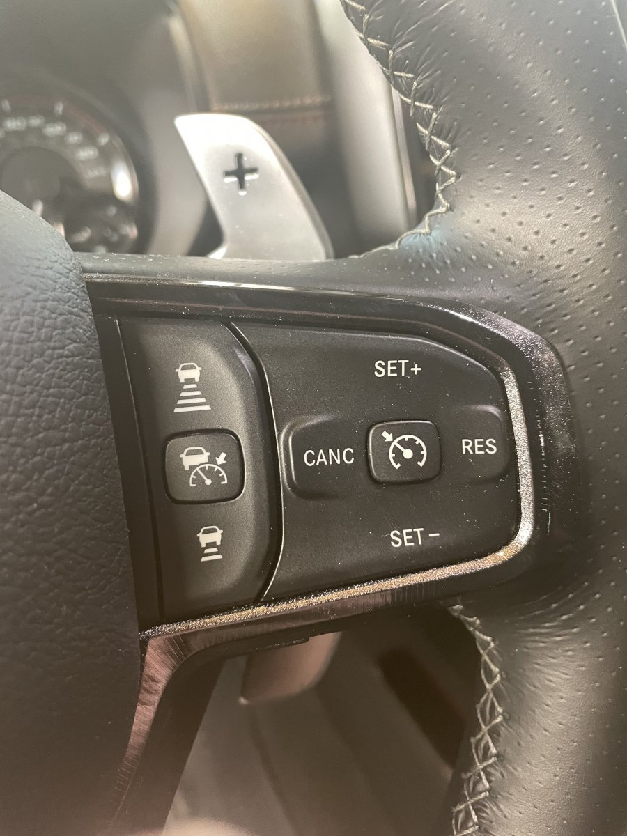

Found out that it is very easy to add Adaptive Cruise Control to our trucks. All TRX’s come with all the needed components so all you need to do is buy the ACC steering wheel switch, install it, then turn on with AlfaOBD.
The part# for the switch is 68309592AD. Next post has info on what is needed to turn it on in the bcm.

I should have all the parts, software, and modules within the next few days to be able to install this. Might wait till next weekend because I have to remove the airbag and pull the steering wheel apart to swap the switch panel and I don’t want to run into an issue and then not have a way to get to work the next day.
1,821
1,350

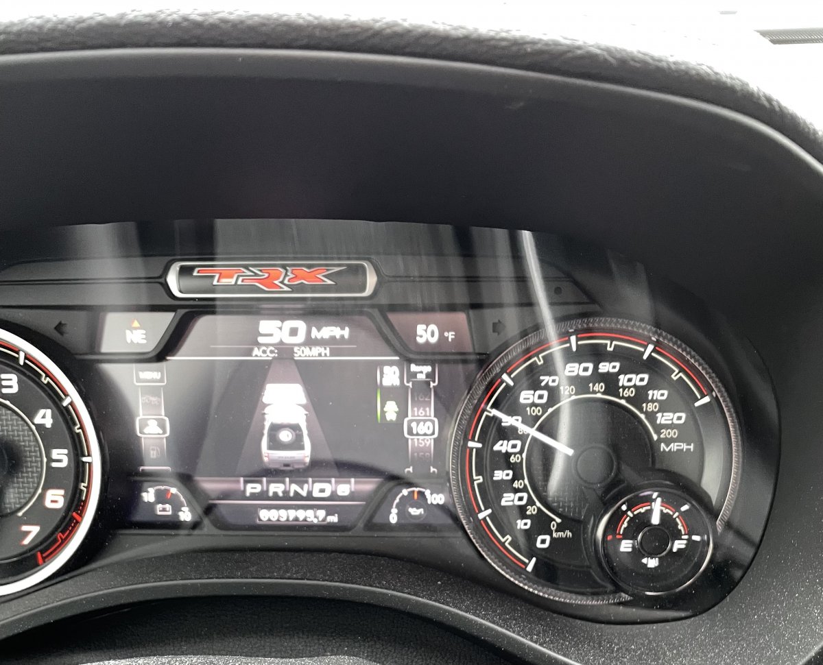

Got this done today. Installing the switch is pretty easy. I followed this video on how to.
For AlfaOBD there are two settings.
(VehConfig 2-Cruise Control Preset) set to NO ***make sure do do this 1st
(VehConfig 7-Type of Adaptive Cruise) set to ACC with stop and go
after I did this i let the truck completely shut everything down. When I started it I got errors for the collision warning and the ACC was not recognized. I was expecting this. I had to reset the ECU in AlfaOBD. After the reset my changes were still set and when I started the truck up no codes and ACC was able to turn on.
