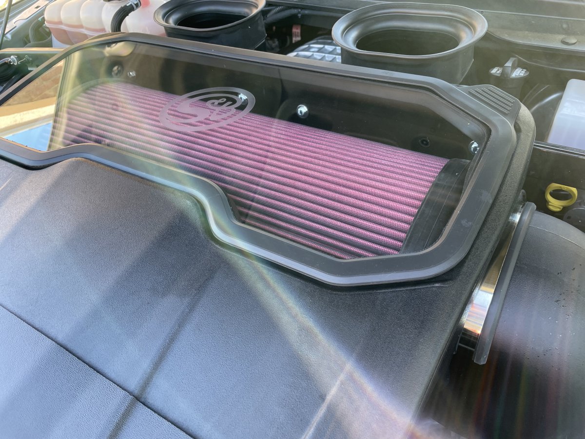

Got the S&B installed first thing this morning. Install was very simple, especially since I had already been in there once to fit the Super Stock tube. Took a little over an hour. Honestly the hardest part was struggling with the stupid clear plastic lid. Took some wrestling to get it in.
Everything looks and fits good though.

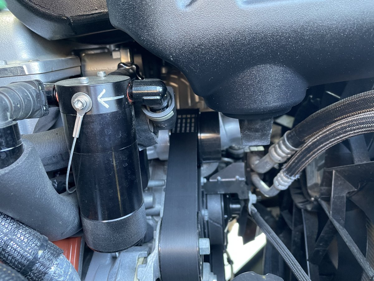

It even clears the UPR catch can which was a huge relief.
Driving impressions: The sound with the lid on is identical to the AFE Super Stock. I would have never known the intake was even swapped. It will be noticeable if you’re going from stock to the S&B though. Sounds good. Not obnoxious. Very subtle in auto mode and more vocal in sport when you wind it out.
For some basic testing, I did 5 0-60 Dragy runs with the Super Stock first. Based on Dragy data, ambient temp was 70 degrees, DA was 1682ft. Truck had half tank of 92 octane fuel.
The average 0-60 time with the Super Stock was 4.48 seconds.
After installing the S&B, I drove around a bit to let the truck relearn and warm everything up. I was able to test in very similar weather conditions, and on the same roads. 5 runs, just like the AFE. Temperature was 70, DA was 1666.
I also filled up on fuel before the S&B tests, so the truck was actually around 100lbs heavier. Even still, I recorded an average 0-60 with the S&B of 4.33 seconds. Nice little improvement.
For all tests, I used LC at 2000 rpm. Intake temps were about the same, between 115-125. Coolant, oil and trans temps all at 200-205. IC coolant temp remained consistent too.
I also watched the boost gauge easily hit 11 PSI with the S&B during the runs. I never got over 10 with the AFE in testing, or in regular driving over the last month or two. So their claim of a 1 PSI boost is accurate and lines up with the improvements I measured. Not life changing but there’s worse ways to spend $700 I guess.

Yeah. Think it’s better than a bunch of screws at least. Certainly looks cleaner.

yup. My thinking is it would be nice to be a little easier to remove an install so for regular street driving you could ride with the cover off, but when you want to go off-road throw the cover back on to help keep the filter cleaner.

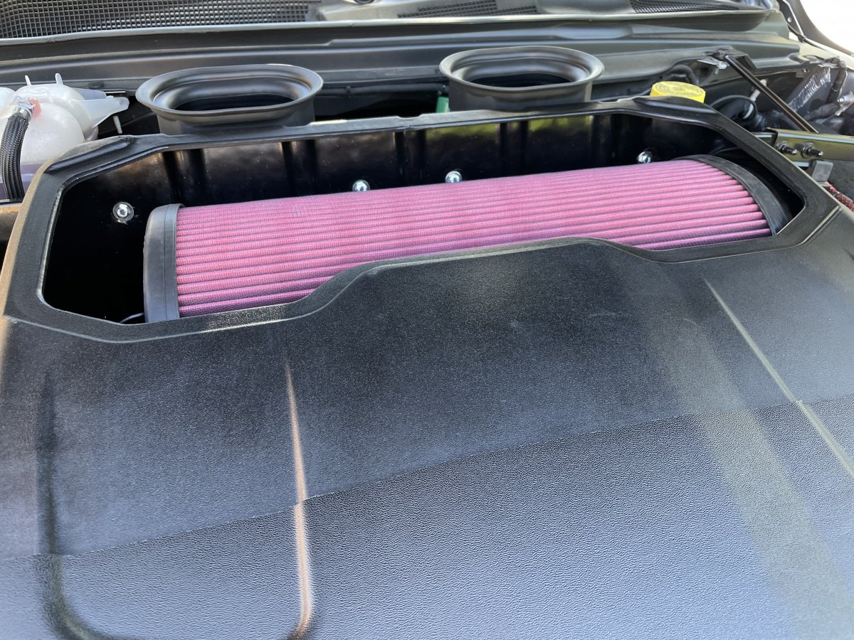

Alright…
It’s definitely louder. But it sounds pretty good and the intake air temperatures weren’t all that much higher. Maybe a 5 degree swing.
I did put the lid back on but for someone wanting a dual personality intake, it’s cool that S&B gives you that option.

thanks for doing that. I like it. I’m sure the video doesn’t sound as good as in person too.

Yeah, it never comes through quite so well on film. I think it would probably get a little old on the day to day driving but like I said, it’s cool to have that option.
You thinking about grabbing one?

They are likely to be evenly matched as far as airflow. My logic was:
1) The AFE seems a little more complicated with two tubes, two filters, etc.
2) The AFE supposedly doesn’t clear my catch can.
On the flip side, the AFE uses nicer clamps and can theoretically be had cheaper if you can find one.
