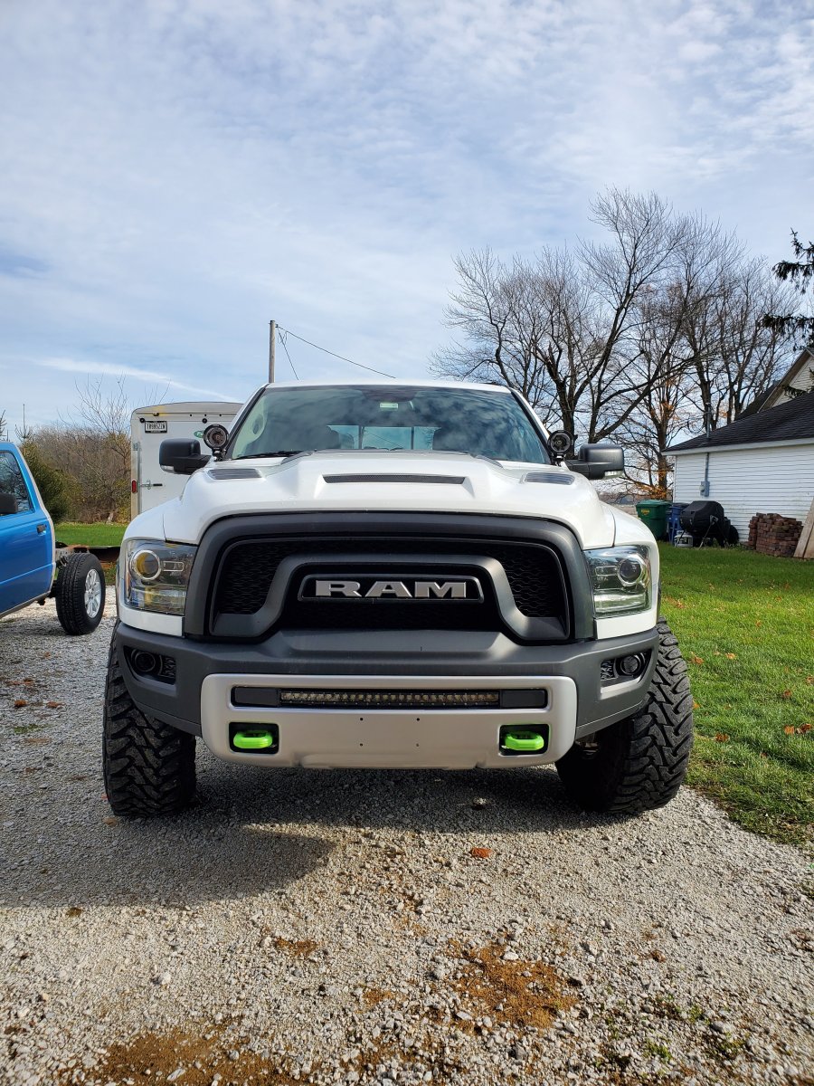

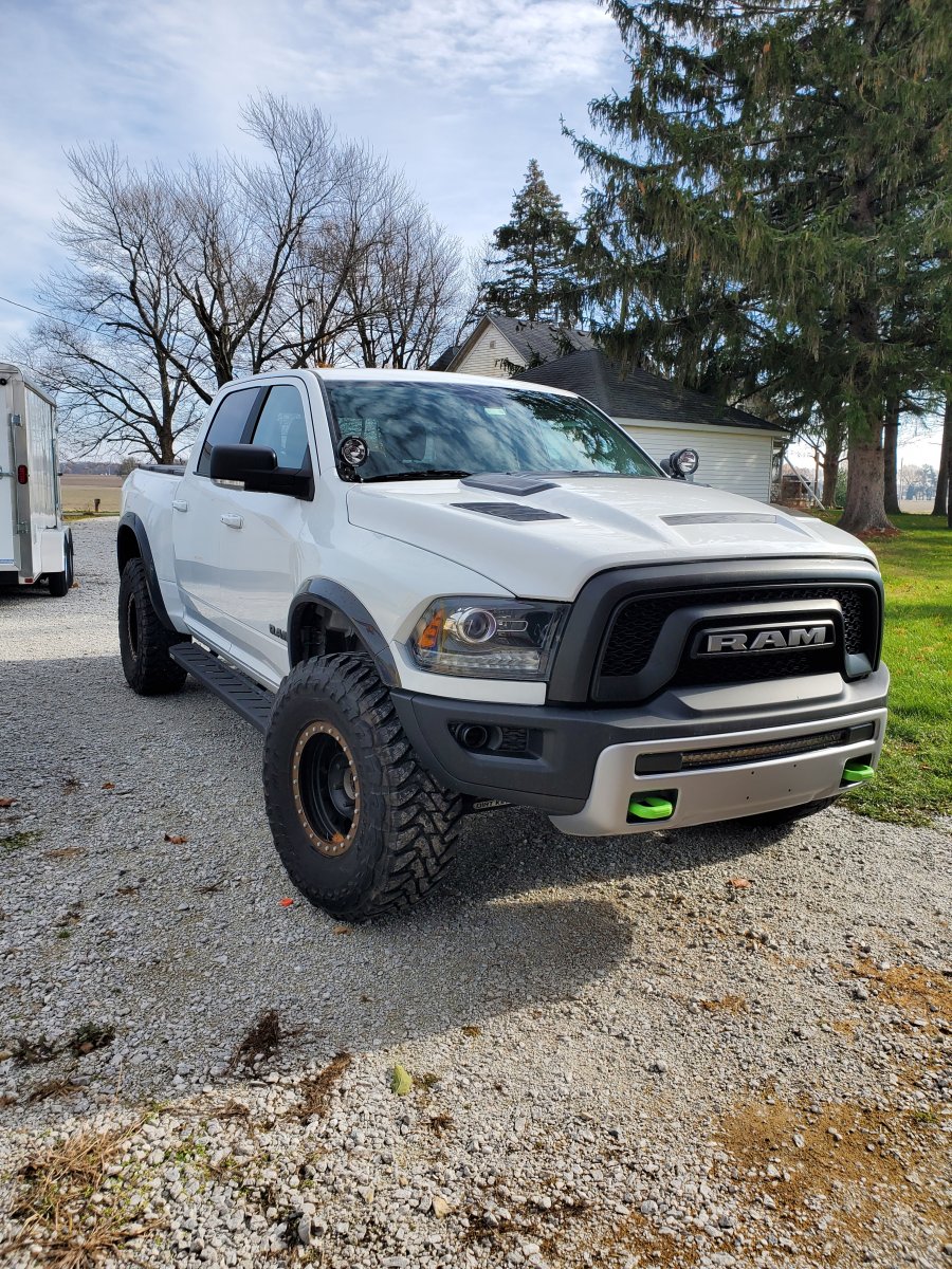

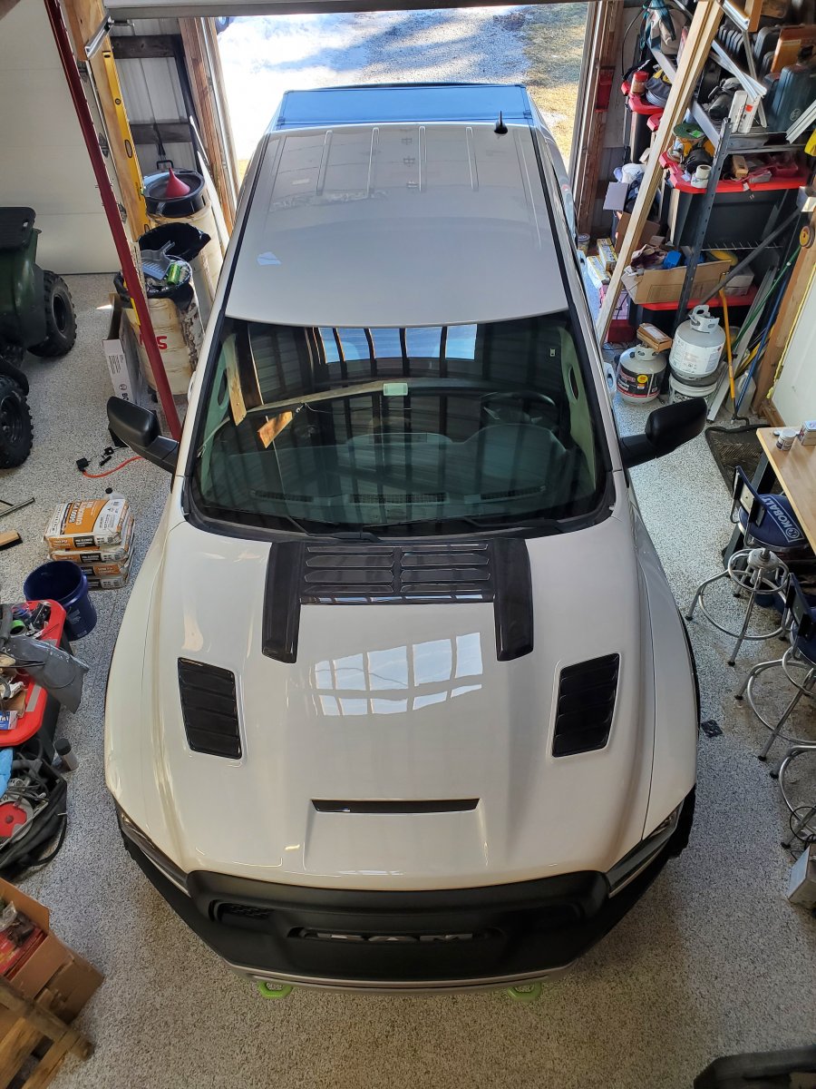

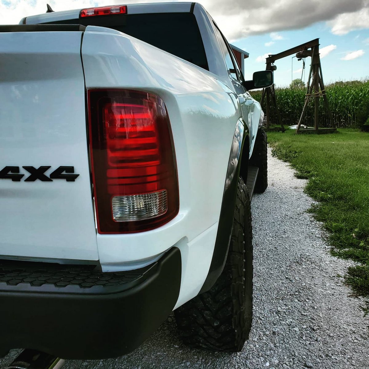

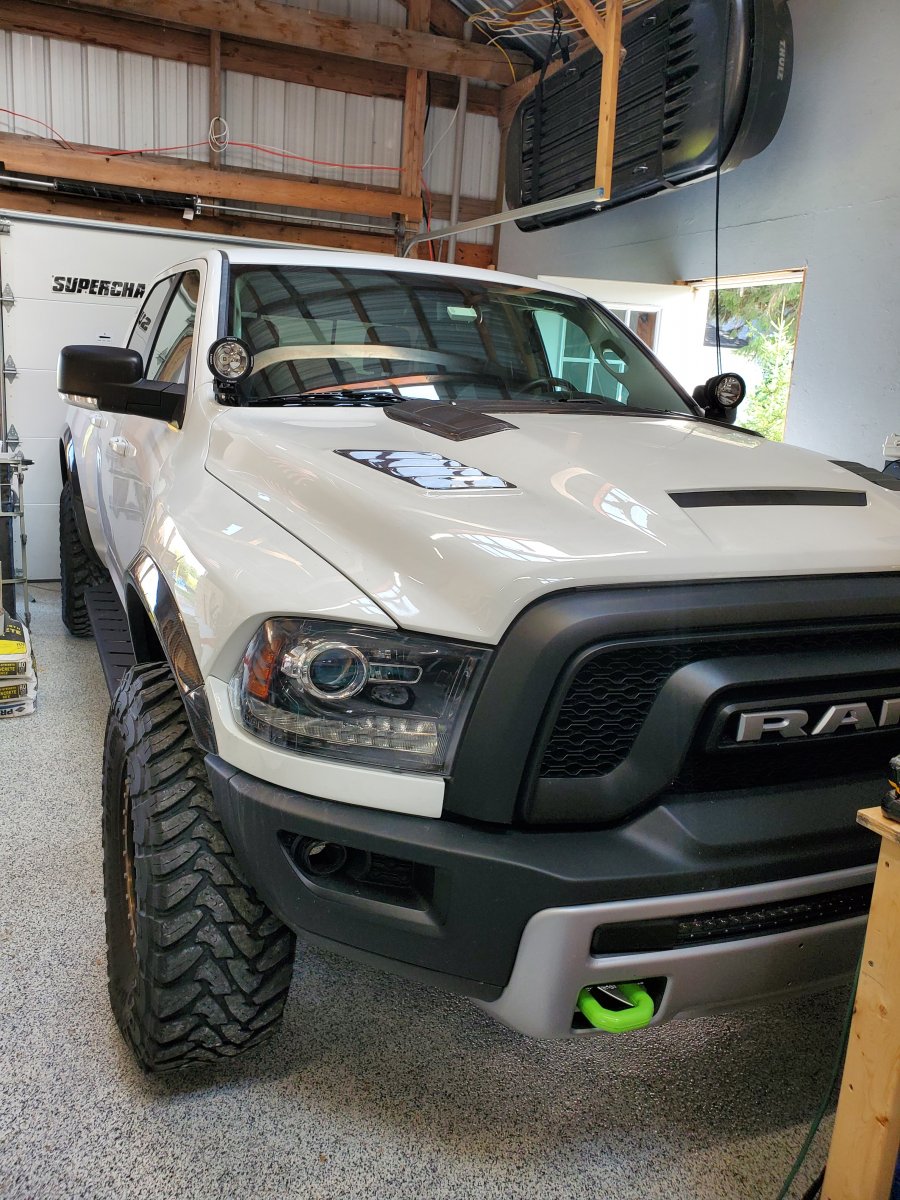

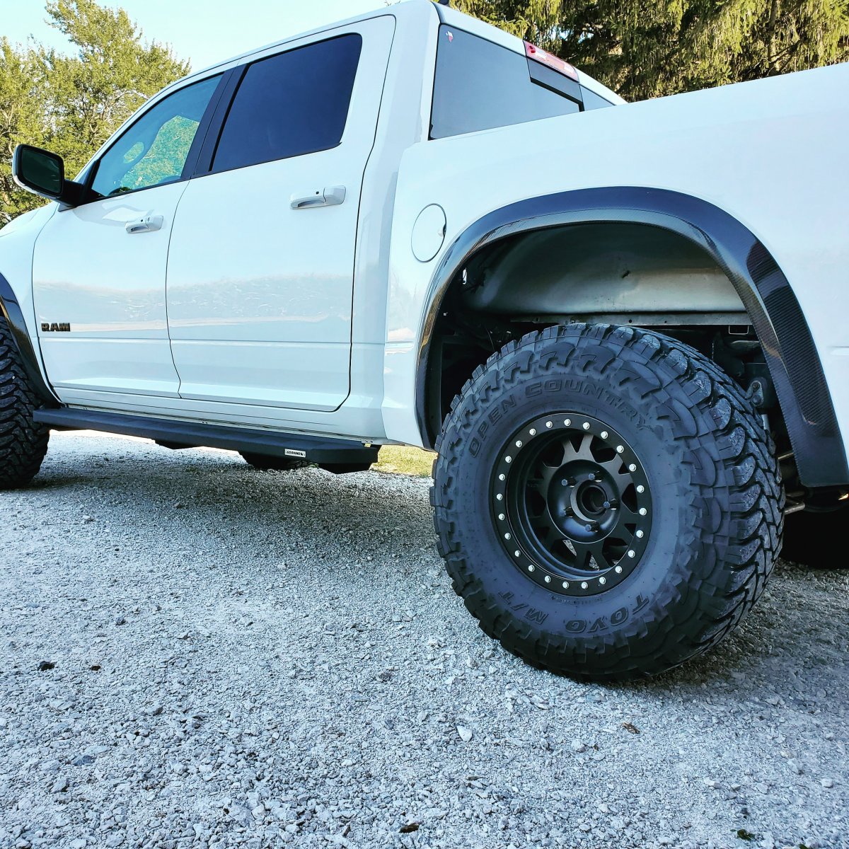

Hey all - I wish I had a new TRX like most members on here, but here is my current setup. 2017 Ram Laramie with Rebel front end conversion, Advanced Fiberglass Concepts TRX kit, Dirt King front and rear long travel suspension, Whipple Supercharger (HEMI Orange of course), Vision X spot lights, Ultra 103 beadlocks...and I'm sure I'm forgetting other things. Happy to be here!View attachment 731View attachment 732View attachment 733View attachment 734

How about just a pic of the full truck? I can't quite make out the full stance of it from the pics you posted.
Hard to get a good angle for perspective. Here are a couple more shots.
