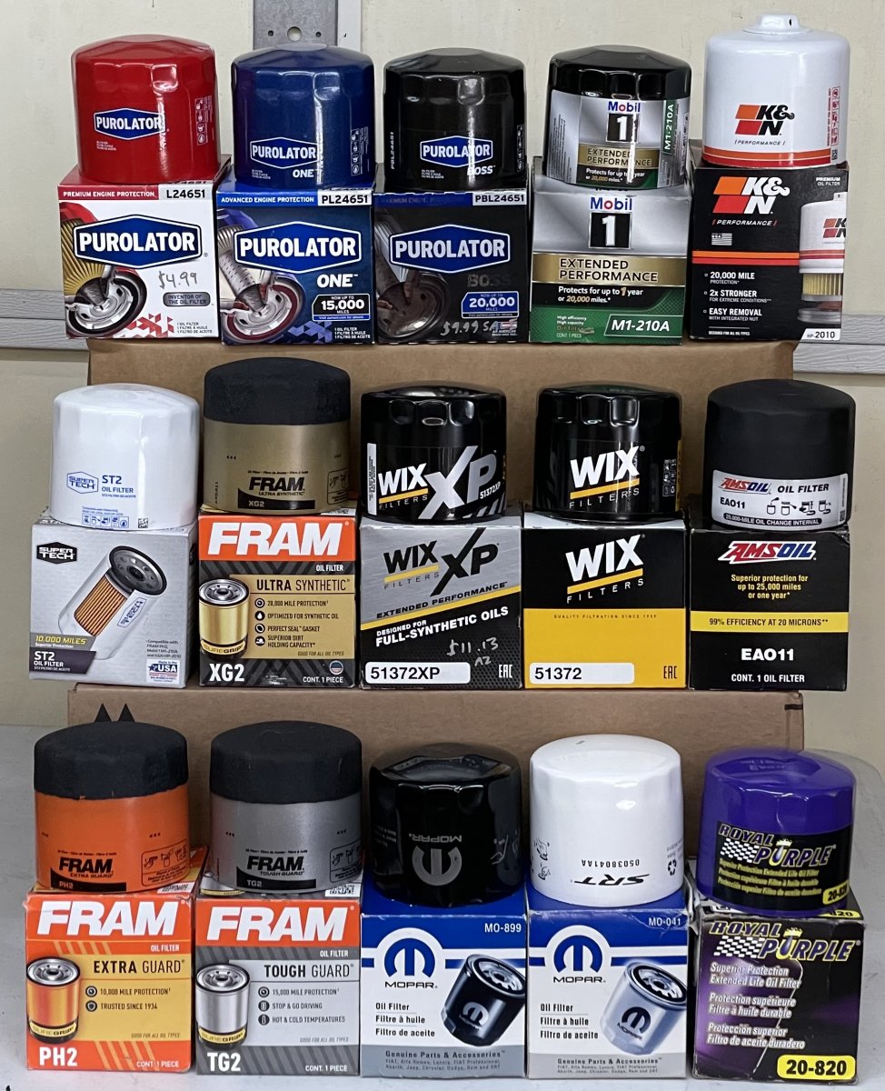

Filters Filters Filters, 15 cut and compared

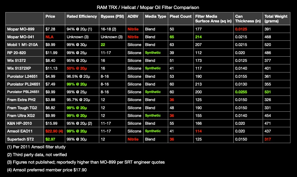

Worked on this filter test off and on over the last week. Always interesting to see what’s what. I will group them by brand and or supplier to stay within the attachment limit per post.
The data chart, sourced from the manufacturer unless noted. Also attached as PDF.

  • OIL FILTER CHART.pdf

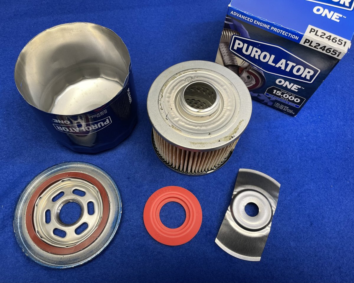

Purolator / Mann filters:

Purolator PureOne:
The PureOne is a good midrange filter. Very efficient and decent build quality. Much like the MO-899, the metal end caps weren’t very tight on there.

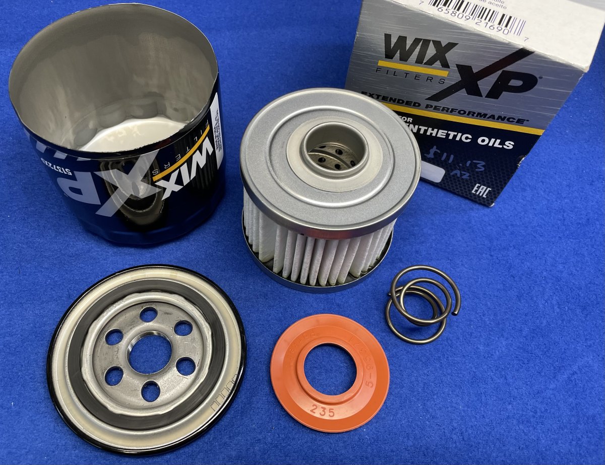

Wix
Wix 51372XP:
Overall build quality is good with wire backed synthetic media, BUT it is geared solely toward long drain intervals. As such, the efficiency rating is the worst by far. In the independent test chart it did not do much better than rated. In fact, it was off the scale bad. Unfortunately there are much better options with media that provide good flow, good capacity AND better filtration.
Wix 51372:
Pleats are fairly evenly spaced, but put together a bit sloppily with messy glue on the filter media along the seam. It’s a perfectly fine filter though. I would use it over the XP based on the fact that it actually filters.
…more data to come later, but that’s all of the filters and some brief thoughts.
Of the bunch I can sort them into 3 groups (just my opinion based on what I saw, the performance, and the quality)…
Would use:
Royal Purple
MO-041 (currently using)
Purolator Boss
Fram Ultra
Okay, but wouldn’t go out of my way to buy:
MO-899
Wix
Mobil 1 (Boss is better for same $)
K&N (overpriced vs Royal Purple)
Amsoil (terrible value)
PureOne
Would not use:
Wix XP (expensive rock catcher, awful efficiency)
Fram Tough Guard
Fram Extra Guard
SuperTech
Purolator Classic (okay but a little too “budget” for this truck)
