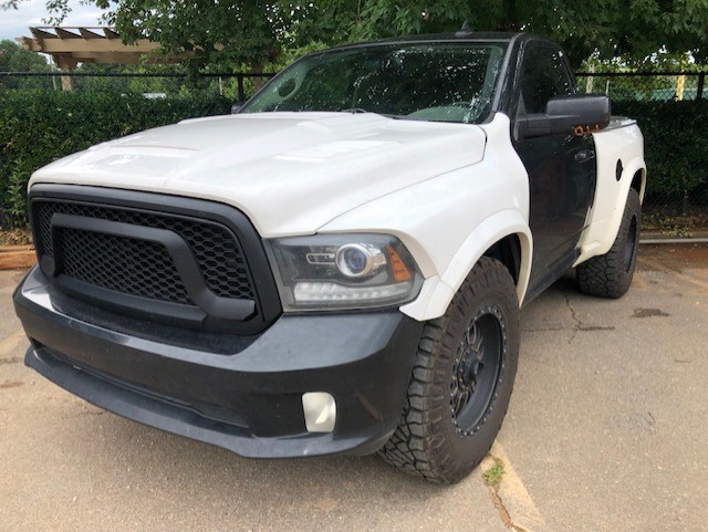

Anyways I had some time to think about it and backed out. I'm currently building a replica TRX with some personalized touches. It will be a 2014 RC SWB Sport 1500 4x4. I have the TRX kit from Advance Fiberglass, Staggered 37" Nittos, Whipple Supercharger (not installed yet) and several other goodies.
Although she want be the beast the New TRX's are she'll be something personalized and different. I'm thinking about naming her Li'l Rex. Meanwhile, I too will be drooling over these Beast!!

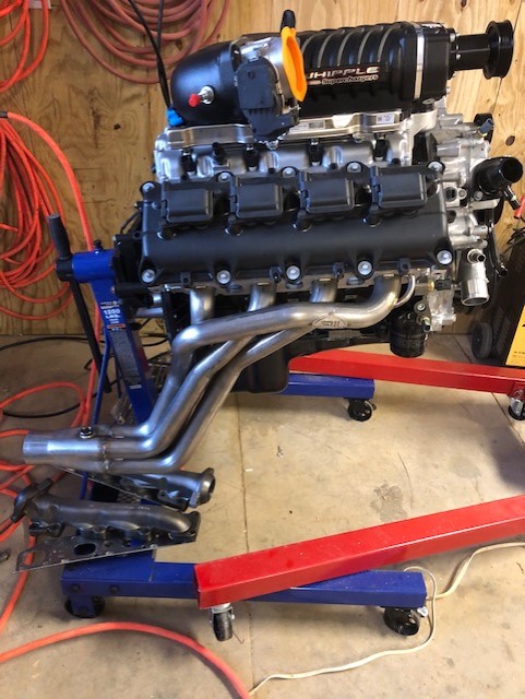

That's a great idea. I can't wait to see what she looks like when finished. Are you going to beef up the 5.7 Hemi internals before supercharging or just use it as is?

I have a new stock complete engine. I have to re-gap the rings for the charger. So while I'm in the engine, I plan to install a supercharger profile cam system (rollers, springs & phase limiter). I'm still compilating on the MMX forged drop in rods & pistons although the stock one when re-gapped should be fine with the amount of boost (6-7 pounds) I'll be running. MDS delete of coarse and a dyno tune. Other than that, external of the engine, I've already installed a complete Stainless Works exhaust system that should complete the engine performance.

Wow! Who needs a TRX when you have that? Can't wait to see her put together. You will have to make some videos and upload them here! :love:

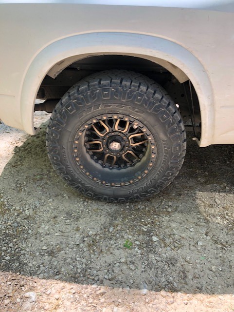

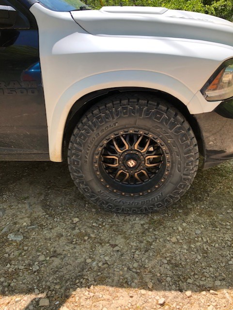

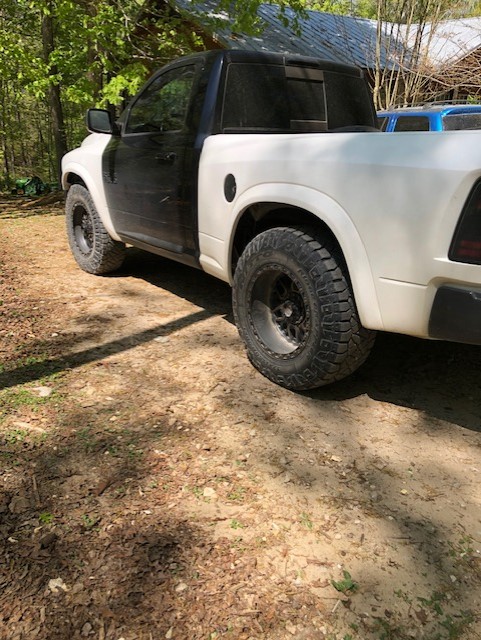

I was looking at Dirt King's long arm travel system on all 4's at one point so she could get airborne like the TRX. But for now I'm keeping the stock ride height with the rake look. I want to morph the look of a TRX and street sport look. It's still a 4x4 and I wanted to stuff 37's under her. It took a lot of research and finessing to get them on a stock set up with no rubbing. I went with the staggered look which goes well with a stock set up. So for now, this puppies staying planted on pavement. I am going to beef up the suspension a bit to better enhance the handling on asphalt as well on dirt roads
Rears:
Wheels; Ballistic Tomahawk 20" x 12" -50. Tires; Nitto Ridge Grappler 37" x 13.5" x 20".
Fronts:
Wheels; Ballistic Tomahawk 20' x 9" -12. Tires; Nitto Ridge Grappler 37" x 11.5" x 20".
