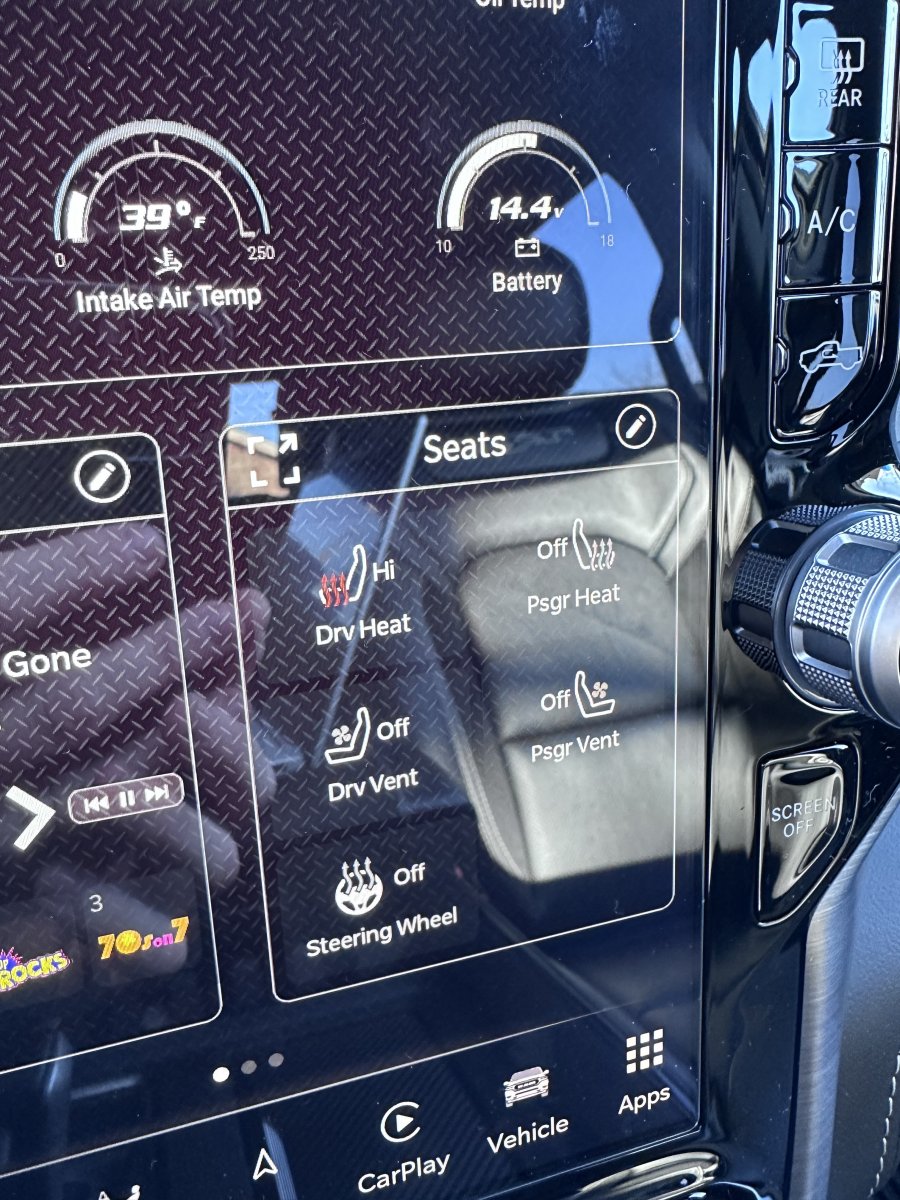

In another attempt to get the heated seats and steering wheel working I made harnesses and installed and pinned them in the connectors today. I don’t have physical buttons so I don’t know if it worked till the soft buttons show up on the screen. I ”think” they will work because all the wires I added were already populated on the opposite side of the connector.

It has been confirmed today that I now have working heated seats and steering wheel.
Also today I upgraded to Uconnect 5. As already stated by onthereel that requires a new screen and new radio module. I bought a screen and radio module combo on ebay and thought I was getting a 2022 radio module but was sent a 2023 radio module. Not really a problem, but just sets me up nicely if I ever go as far as he did wit the digital cluster. The screen I bought came with lane keep assist button and had the trailer brake control attached so I decided to by the trailer brake control module and install that too. Then while in alfaobd I also turned on lane keep assist.
How are you liking the system so far?

Also, @quietpeen , I get three lines/three settings on my heated seat as I should, hi med and low. For what it’s worth when I enabled the 3 level heating on the wheel it didn’t work. Icon doesn’t support it. Same as UC4.

Also, @quietpeen , I get three lines/three settings on my heated seat as I should, hi med and low. For what it’s worth when I enabled the 3 level heating on the wheel it didn’t work. Icon doesn’t support it. Same as UC4.View attachment 4048

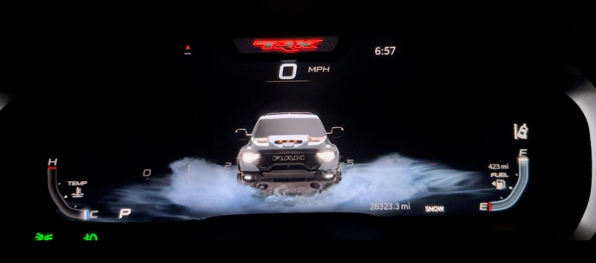

Heck yeah. The analog cluster just shows a regular old Laramie or Limited. Don’t remember which. Same for the tailgate alert.
