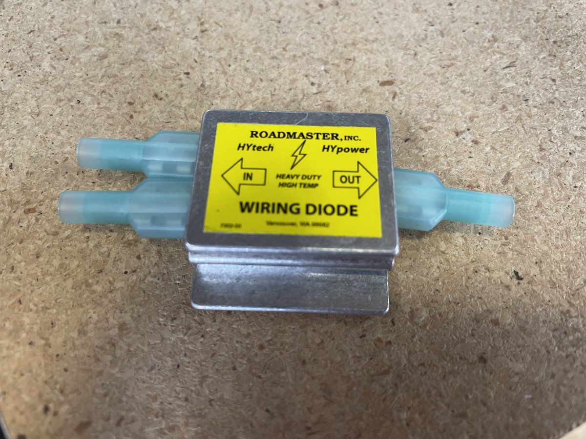

The plug and play will be a big hit. Not to knock on any TRX owners but it seems like a lot aren’t mechanically or electrically inclined. As I posted in the other thread I will be doing my own thing to run them both with reverse, AND on one of the TRX aux switches.
Picked up some of these Roadmaster diodes to prevent the aux switch backfeeding the stock reverse lights and vice-versa. They are sold for dingy towing and should easily handle the load. One input for the aux switch, one input for the relay triggered by the factory lights.
Won’t be plug and play obviously, but if all works well I will post a write up for those interested.
